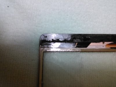

This issue is not surprising considering how thin the digitizer is and where it is located. The design flaw is that they attached the digitizer to the glass rather than the LCD. The digitizer is egg shell thin and while it's fairly well protected where the LCD is, the areas above and below are vulnerable. This is particularly true when the glass flexes. I'll try to upload a picture here that shows the weak areas and how thin the digitizer is there... ok that faint line you see running horizontally from just above the gold contacts on the right is where the digitizer's glass ends. You can see that is all very delicate there. That spot is between where the glass is attached to the frame and where the LCD is glued. So if there is a twist that pulls the lcd one way and the glass another....snap. It wouldn't be common but it is possible in this way to stress the digitizer enough to cause it to have issues.:shocked:

Well they wanted to have a very sensitive screen so they engineered it that way. Then when the production guys got a hold of it they did what production guys do, cut costs. There is a point precision goes out the window when cutting costs.
I have to assume the engineers doing these updates are doing so on pristine phones, otherwise they would have seen the effects of raising capacity on a digitizer that had been flexed.
