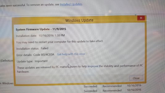

I had tried everything I read in so many posts (draining the battery, updating the driver, rolling back the driver), none of it worked. Once in a while the touchscreen on my Surface 2 would randomly start working after I powered it on (usually after not having used it for a week or so), but as soon as I rebooted it would stop working. Even did a full factory reset and even that failed to fix it. I took it to the Microsoft store and was lucky enough to get a tech girl who has been dealing with the exact same issue on her personal Surface 2. Even she was unsuccessful in fixing the issue on her's, but after picking her brain she was able to give me enough information that put me on the right track to finding the solution.

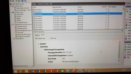

She told me that even though she has not been able to fix her touchscreen, what she did learn was that the issue is caused by a system firmware update dated 11/9/2015 that has a bug in it which Microsoft never fixed. Even when you roll back the driver and you think you fixed the problem, the update keeps trying to install itself as soon as you reboot. The lady at MS said that even though she knew this update was the root of the problem, she did not know the KB# of the file to look for that is associated with the 11/9/15 firmware update so we could uninstall and block it. Using the exact date and time my system installed this update (which was on 10/16/2016 at 1:38 PM as you see in the picture below), I looked in the Event Viewer Log and looked for what update was installed at that exact date and time, and low and behold I figured out what the KB# is that we need. (you don't need to do that, I am just telling you how I figured out what the KB# is)
