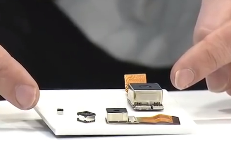

The fact that they managed to fit such a big sensor and the adequate optics in those small housing is impressive. Just look at the difference to conventional camera modules
"From left to right, a front-facing camera, an 'entry level' camera (probably 1/4", but not a million miles from the camera size used in most other smartphones of today), the Lumia 1520's 1/2.5" camera (so very similar to that in the imminent Galaxy S5) and finally, on the right, the Lumia 1020's 1/1.5" unit, positively dwarfing the rest. In fact, every time I look at this photo and then look at the Lumia 1020,"
