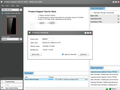

Holy bleep they are right...the '1314' ATT 820 North America is in Nokia Care Suites to download and update. Not sure how long it has been there (I checked a while back and it was not) but I ASSUME this means ATT will be sending out the 'over-the-air' update soon....but then again it is ATT :) Here is a link on how to use Nokia Care Suites update (but remember this resets your phone so do the normal backup thing and maybe screen capture your start screen if you want everything exactly the same). Can't wait to clear up storage!!!!!!!!!!

And here is a print screen of what I am downloading...I assume all ATT USA 820 phones will be the same:
edit: well my download failed about halfway through, but it failed last time I was at work when I downloaded my current firmware so I will try later tonight or early in the week again.

My firmware download failed halfway through...I tried a few times. I will try again when I get home...if I can download the firmware I will update if it worked for me or not.
