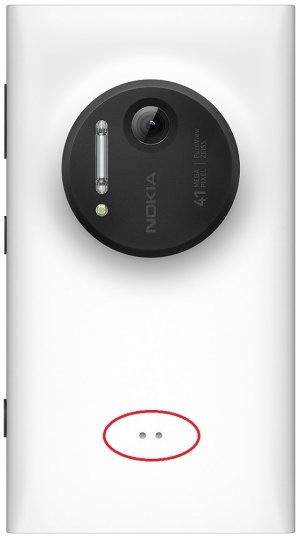

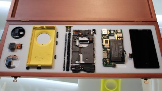

Ok, so my phone is dead (i mean flex cable) and I can no longer charge it anyways. Till I get my new housing, is there a possibility that I could charge it through two holes on the back by connecting some wires from a power supply? Anyone knows which one is + and -?
PS. I wonder, where how did they do this??
