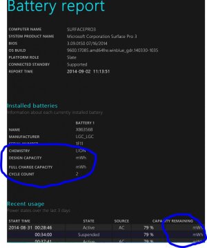

Hi,
I got my SP3 i5/128 on august 28 (Release day here in Sweden).
I'm not able to charge the battery to 100%, when the battery charge is around 74-79% it stops charging. If I hover the battery indicator it says " 75% left (Plugged in not charging)".
I have completely drained the battery 2 times with no success. I have tried resetting and reinstall windows with no success. All windows update is installed including August firmware.
One strange thing I have noticed is when I run powercfg /batteryreport, there is no Capacity figures(Se pic), is this normal!?
Have anyone else have this problem? Is it a hardware problem or a software glitch?

I guess I have to send it back for repair then!? That sucks, besides the battery charge issue I really love this awesome machine...
Just checked my battery report and all looks good for me. I DO see values for the Design/Fuel Charge Capacity mWh on my SP3
