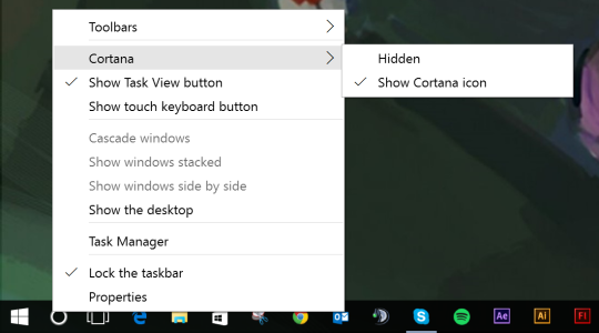

Currently on Windows 10 my Cortana is only showing up as an icon on my taskbar (the two circle rings). Every screenshot I see of people using Windows 10 has a fully fledged toolbar for Cortana on their taskbar. I've checked all the taskbar settings and Cortana settings and still can't get the bar to show up. Any help?
Right click on the Cortana icon on the taskbar. In the pop-up list, select Cortana, then select "Show Search Box." Problem solved. :)
That option is not available. How do you make it appear?
Thanks for the attached screenshot. That helped me understand what you were seeing. It took quite a while experimenting with different settings to finally duplicate what was happening.
For your Taskbar settings, you have "Use small taskbar buttons" checked. Right click on the taskbar, select properties, and uncheck that box, and you will make the search box option appear. It's incompatible with the smaller taskbar height.
Glad we discovered that. Perhaps it will help others with that issue. Looks like if you want it small, you don't want the search box, or at least that's the way Microsoft saw it.
Wow you're right. That is incredibly bizarre. Thanks for the help, I got it to work just like you said.

I had upgraded to Windows 10 before 2-3 months, so while setting up my system, I had selected to make Cortana Icon to be smaller on Taskbar, so it just been displayed as two-rings Cortana Icon. But, now I want the same Search bar as we get it while we install the system. I tried every possible factor but not able to find that option under Cortana option which is "Show Search Box". I have only two option from the taskbar menu for Cortana which are Hidden & Show Cortana Icon.

Right click taskbar. Left click settings. Turn off use small task bar button. Right click taskbar and right click Cortona. Click show search box,
