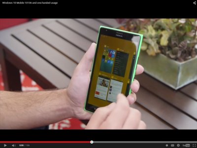

anybody saw this type of task switcher in the latest 10136 update ? there are four screen previews .Task.jpg
