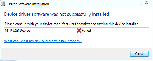

Hi all,
My Lumia 930 is not being recognized when plugging into my windows 7 enterprise laptop (works fine when plugging into a windows 8 laptop).
I get the following error message:
Device driver software was not successfully installed
MTP USB Device Failed
Is there a specific driver available to download? I have searched through a few with no success.
Thanks
Is it possible that you have the windows 7 enterprise N version?
You can check that by right clicking on Start button --> System
If so you need to download it.
https://forums.windowscentral.com/e...ad%2Fdetails.aspx%3Fid%3D16546&token=9AMMVOjl
See below related post about connection problems without WMP
http://forums.windowscentral.com/wi...ant-connect-my-lumia-my-pc-windows-8-1-a.html
I found a solution for MTP-USB driver does not install | Windows Secrets Lounge
Good luck
Or install the WPRT or LSRT these also may include the needed drivers.
