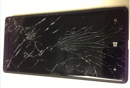

Ok, So I cracked my Screen by dropping it pocket height and it happened to hit the bottom left corner of the phone and the screen split into a million cracks.
The phone itself was still operable, but it was just ugly.
So I tried to repair the phone myself and was able to fully repair the phone, sort of.

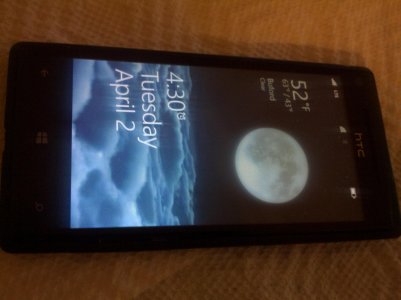

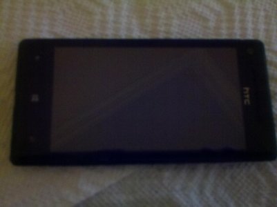

Result of repair pics:

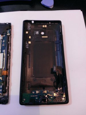

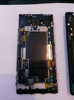

Took my wife's 8x apart to replace the screen/digitizer. I purchased a new one and am trying to get things hooked back up. I can't figure out what I am missing. On the upper left, it appears I need to reattach a ribbon cable. I don't see it anywhere. I have circled it in the pic in the center. Any help would be appreciated. Thanks.

I figured out it is the home button flex cable that is missing. Anyone have an extra, let me know.

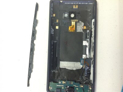

I had the same issue. On the left side the glass does not lay flush with the housing. To fix this you need to pry out the spacer tab (for lack of better terms). If you look at the inside left part of the housing there is a plastic piece with notches that run along the whole side. If you look closely you can pry this plastic piece out. It's held on by adhesive. With that piece removed the digi/LCD fits perfectly.

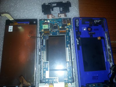

I did all the tests before to take a part my htc 8x, fully functional apart of the screen, the Chinese tools did a good the job and now just waiting for the delivery of a new lcd and digitizer($56). No issues yet.
