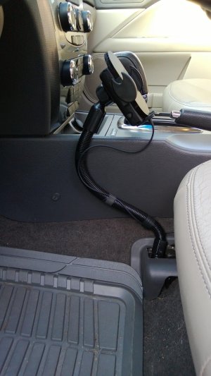

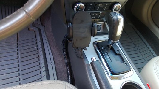

Yes on TPMS. No on problems. I have finished my little project and should have pictures in a few days. I ended up removing the back of the wireless plate. Then attached it to my new phone holder. I am using the Akron 18" floor mount phone holder from Amazon.

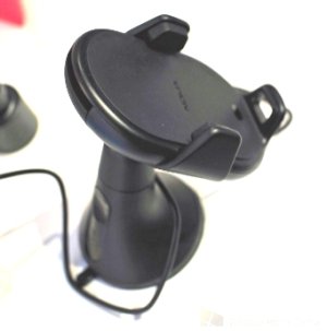

I got the same cradle although I don't have the arm extension. I have the suction cup that I use for my dash. Do you have issues making sure the cradle hold your phone well? For me, the clamp on the side doesn't hold the phone. So the phone has a tendency to fall out while I'm driving.

I removed the back of the charging plate to get a few more millimeters back. That was enough for mine. Also, since mine is lower, it points up a bit. So, I have gravity on my side too.
