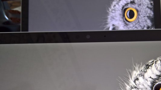

All new surface pro models i have seen had this yellow tint.
New surface in the front, pro4 in the back.
The new Surface Pro has an added color space called "Enhanced". It's the Microsoft equivalent of the torch mode of Samsung devices and other devices where the intensity is very strong. Do you have Enhanced enabled?

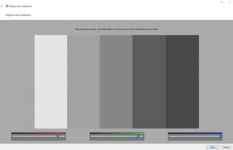

Hi there, I have the same issue and it drives me nuts. I was able to make it at least somewhat less noticeable (the change over 2 seconds after login is far less dramatic) by doing this:
--Search for "Color Management" and under the "Advanced" tab click on "Calibrate display"
--Click past the first few settings (brightness, contrast, etc) until you get to color balance
--The red, green, and blue sliders were set all the way to the right on my system. If you move the red and green closer to this (about 90% red, about 93% green), it should help:
It's not perfect but pretty close, I plan to play around with it a bit more and see what happens. Good luck!
