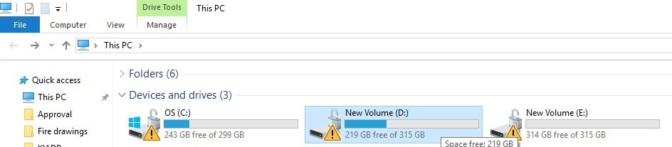

It is displaying following symbols on the C,D and E drives.
It's a Drive Encryption (Bit Locker) warning message. I'm also using Windows 10 Pro.
Kindly help on this to remove this notification on the drives.
