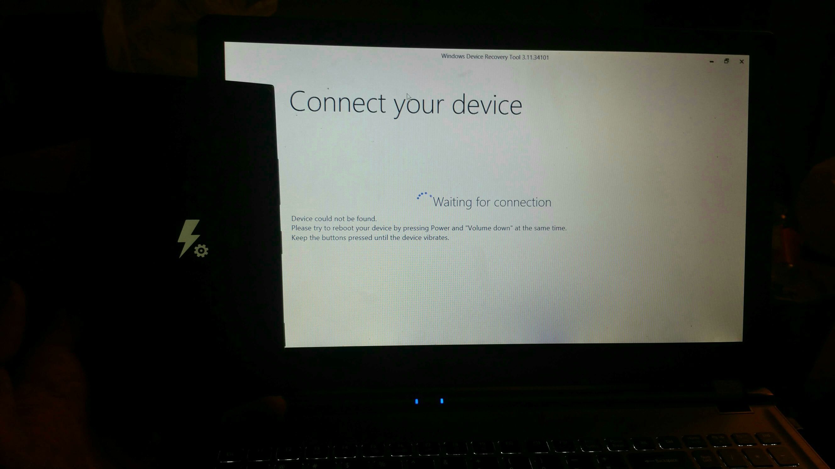

After some charging, I get this:
I swear I'm not trolling, but this is actually kind of funny to me. It's almost justifying the purchase of the Elite x3, but I'd rather save money and salvage this

Can you boot into Flashing Mode (Lightning Bolt & Gear) and try the WDRT again?
I'm going to see if I can get some others in here looking at this thread.
Team Corsair
Dec 20, 2016
16
Visit site
No bananas again :p Device still can not be found according to WDRT. for kicks I even looked around device manager since I believe I've read that the USB controller might state Nokia around there. No dice. I'm not ready to give up! I could mail it to you to fiddle around with :-D
