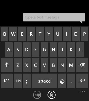

I was not able to test it and went for a hard reset, hoping it would solve the issue. And here I land into another trouble. :(
Earlier the mic was not working. But now the mic icon itself is gone from the messaging app. I remember having it there till yesterday, but now its not. And yes the speakerphone issue is still unsolved. No voice recordings/music IDs in my smartphone. :angry:
Whats happening with these 930s? Definitely #L930 is the most #buggy #Flagship ever made.
Chomiq
Jul 7, 2015
167
Visit site
Language, region set to English? Microphone icon in messenger app is for speech recognition afaik. No mic icon here with lang/region set to Polish. From what I see you have input set to Hindi.
