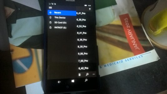

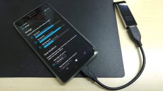

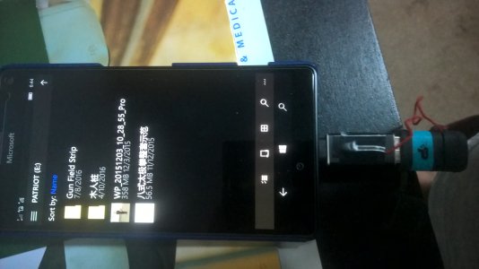

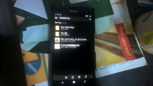

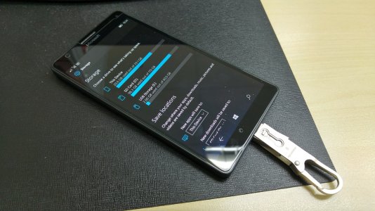

OTG confirm supported. Working out-of-the-box since the very first version of the OS & firmware, direct Type-C flash drive or via a Type-C to Type A female converter.

USB OTG works splendidly on my 950 - I use it every day. I also have the Victsing adaptor and a couple of other cables. I also have one of those dual usb sticks (the one with type C in one end, and type A in the other), I connect normal flash drives and harddisks at least a few times a week, and it all works as it's supposed to.
I haven't tried connecting non-storage things as of yet (mice, keyboards, etc.).
