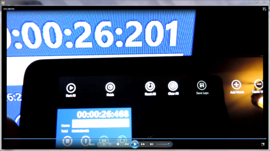

One thing I saw someone else do is run a stopwatch application with millisecond precision so you could see the delay just by capturing a frame.

Thanks for the directions. 267ms delay when next to the tv.
Smart! I would have never thought of that lol. I find this acceptable actually, and just ordered one :).
