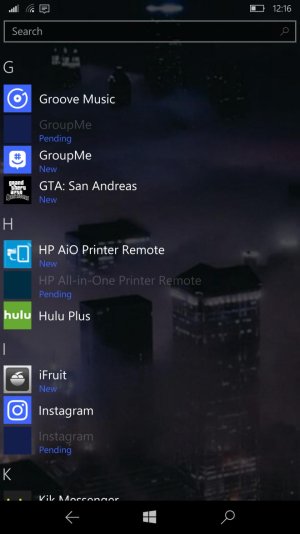

eddieDOTexe
Nov 15, 2012
274
Visit site
Look at this ****
LOOK. AT. THIS. ****.
Not to mention the fact that this screenshot didn't automatically upload to my Onedrive, nor did it when I tried to manually upload it from the Photos app.
and that Cortana's listening service just randomly decided to crash so bye "Hey Cortana"
And eventually my sound stopped working altogether for calls until I restarted.
This is annoying
Really sucks
Buy $400 phone but it runs like a Galaxy J7
