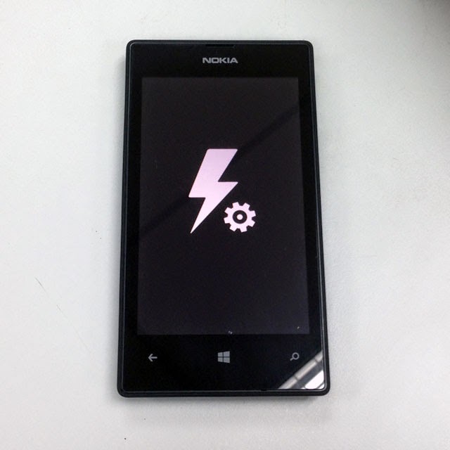

I think WDRT uses a different command to flash from the gear/lightning screen. The command you have with the actual ffu file defined gives the same result.
I did figure out that I can put my device into Emg mode by holding both vol up and vol down in at the same time, but it does not accept any emergency thor2 commands.
@Nate W
What's the screen appears when you flash with WDRT ? I means, it's UEFI flash app, or it's FFU Download mode (like that) ?
Edit : it's FFU Download mode (used, e.g, with FFUTool.exe and ImageDesigner.exe). So, it's sure that it's not this thor2 command that's executed. It's either with another thor2 command (but I doubt, I don't see a thor2 command that allow flash from FFU Download mode), or either directly with WDRT (FFUComponents.dll and ToolsCommon.dll are used by FFUTool.exe and ImageDesigner.exe, but those programs aren't presents).
The HP elite X3 flashes this way too. I am not certain yet.
Correct, and by that reason Alcatel, HP, and or others choose to explicitly use flash file download mode. I caught the commands used on the Elite X3 last year, but I lost those logs...
