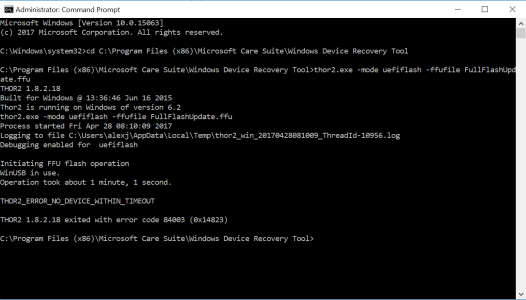

To give some context I bought the Idol from Amazon and having encountered camera issues on the Fast ring flashed the T-Mobile ffu with WDRT.
I tried flashing with thor2 on two different laptops without success. Having tried with the Idol both in flash mode and booted thor2 returns the same error as the attached image.
I also tried using WPID too which gives more detail on the error. The device is listed as ALCATEL.8996.IDOL4S.1.0 while the ffu image has ALCATEL.8996.IDOL4S.NA.
I changed the value data in HKLM/SYSTEM/Platform/DeviceTargetingInfo/PhoneModelName to IDOL 4S with Windows 10 NA but the WPID error remains.
What do you reckon, has the T-Mobile ffu changed the device ID from ALCATEL.8996.IDOL4S.NA to ALCATEL.8996.IDOL4S.1.0?
Could anyone with the unlocked variant check this by resetting their device with the Open Market ffu and WPID?
from what you have tried there it does seem if you flashed the open market 4s with the tmobile FFU it has actually changed the device ID, which sucks balls. I hope that is not the case.
The platform id is not pulled from the registry. Thanks for this find. I can take a look later tonight and add more info too.
Not true. I had the open market and could not flash either. Seems all the phones are provisioned the same. The open market ffu was provisioned different from most of the phones or maybe all. I could be wrong but I flashed the T-Mobile rom because I wanted off the fast ring. That was the only way I could do it. I think I know how to change that ID though to flash the open market rom.
