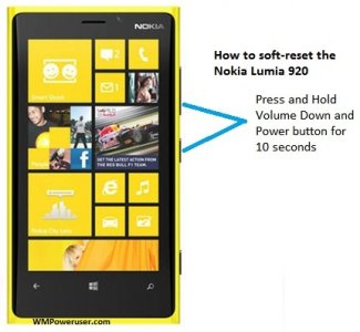

I have trouble flashing my att 920. I keep getting an error: 0xFA001304: Platform ID check fails. Reason(s): The FFU file is not meant for this product. The platform ID of image does not match with platform ID of the device.
Anybody know what the cause of that problem is?
Of all the problems I ran into at the beginning, I didn't run into this one. Shouldn't have trouble flashing other ROMS to it, (I just did it many times.)
Try this: start the recovery, and do what this image says at the same time.
If your phone is in the wrong USB mode, this might help with it. (I think people run into the error you are running into when the phone isn't connected in the right USB mode. I could be very wrong, but it's worth a shot.) Timing might be off, but if Nokia Care Suite asks for you to redo the reset in the image above, then you've got it. (After doing the reset again and clicking retry in the program, of course.) If you get thrown the same error, then I've got nothing. :-/
