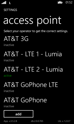

I suppose I'm one of the unlucky ones to not live in a refarmed area... It doesn't appear to have worked. I guess the "fastest connection" menu option on the Rogers firmware is very useful to me now, no need to go higher than 2G, ever... Better battery life for me!
