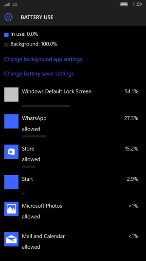

my 950xl doesn't have battery drain problem and each app appears once in the list. i performed an experiment. i left the phone idle for 24 hours and saw which apps consumed most in background. the result is as shown:

Are the ones not in your list actually using background tasks on the phone and using battery (what does the battery use meter say)?
