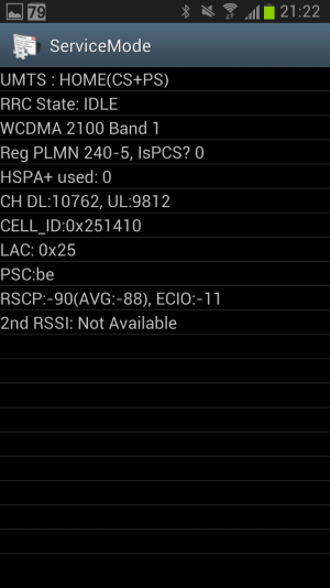

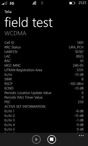

Hello,
Firstly I hesitated a bit before posting this but cannot accept this difference without some kind of rational explanation.
Please view attached screenshots which more or less shows the big difference in 3G reception between a brand new 820 and a SGS3.
They are on the same carrier, same location and cell ID (240-05) and have been this way since unpacked a couple of days ago.
Another thing is that on GSM/EDGE and LTE the signal is strong and "normal" compared to other devices.
Is this normal or should I ask for a replacement?
Maybe someone else have noticed the same?
/Per

Of course, there are always two sides of a coin but the RSCP value shouldn't diff that much between manufacturers and also I just had the opportunity to measure the same thing with an IP5 and the results were the same. It doesn't affect the speed more than switching to EDGE more often than necessary compared to the other devices.
/Per
