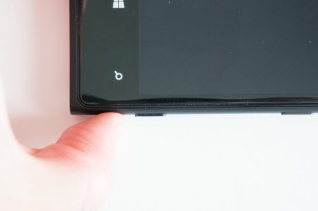

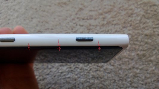

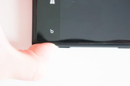

I got my replacement and whilst it is very solid and has no creaking it still has a rather large gap between the case and bezel around the display. Larger than my original one. It is as if the screen isn't sitting inside the case properly, like it is raised up. Has me worried that the case could become loose again. There's dirt and gunk gathering in there already.
Here's what my replacement one looks like, taken by my original 920. Zoom in and hopefully you can make it out.
thanks for the pic devize

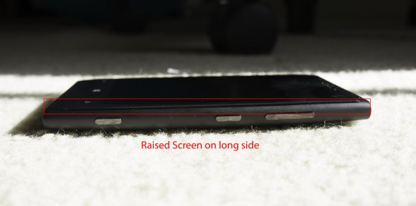

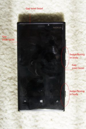

I've sent off email to nokia with my photos and hopefully they will send me replacement phone. I've got gap between bezel & screen on left, top and right. also got 2 bulge/flexing spots. side view of phone also shows the raised screen like your photo. :(
what are you going to do? Since the old one creaks and this new one is not much better.

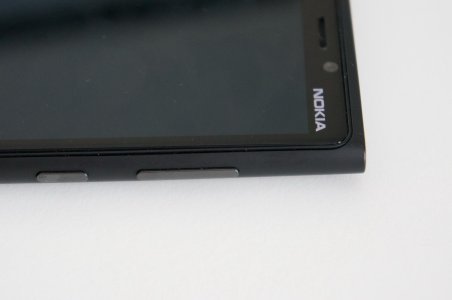

top view
side view
close up
bulge next to camera button, before pressing body into screen
after
