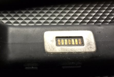

Corrosion on mine after 5 days and it started not charging properly thus the shut downs clean the terminals on the back of the watch so the charger works and down load the band sync app to your puter so the USB will work with it and sync/charge also turn on the puter Bluetooth and pair them.
