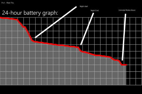

Ok... so some more details on this. Pics to backup my experience.
Good news is, this is repeatable.
Wed: Reset phone again (Settings/About/Reset) restoring to clean OS including Nokia Music. This was the first overnight battery graph (from Battery Stats):
You can see where overnight, the battery declined around 1.5%/hour, using 10% of battery while doing 'nothing'... this happens ALL day but is easiest to see at night.
I then uninstalled Nokia Music before charging.
Note that ffter this reset, I did reinstall many apps including some that use location services. I kept away from those with 'known' battery issues like WhatsApp and Nokia Drive. I had around 6 Mail accounts on the device with 4 with live EAS email, 2 with hourly.
Here is when I then charged the phone through to today:
You can see I let it charge a while and then decided to use it so the level was not at 100% - the phone stays at 100% longer than other levels and I consider that artificially held high.
I installed a few more apps, played some games and made the mistake of installed Nokia Drive during that time.
You can see that after Drive had been run and the phone was idle, with no route entered, clearly the GPS was still on using power (and the phone even felt warm). So I uninstalled Drive before going to bed last night and that restored low usage.
The flat line is the phone with no Nokia music (and no Drive), no Whatsapp or Skype, but still has many email accounts and other apps (games like Wordament, Sudoku) and news like (BBC and USAToday) installed.
So... this is a repeated experiment with screenshots showing that 1.5% / hour is unnecessary on this phone, and should not be expected.
Apps like Nokia Music (my initial focus), but also Nokia Drive use significant power when they should not. I would guess Drive leaves the GPS on given the power usage. Music, well it's anyone's guess, but an idle music app playing no music should not do this.
And... I believe if my experiment holds out and reproduces exactly, reinstalling Nokia Music now from the store will likely show 0 usage. So either the store version is different with this bug fixed, or a second install fixes something broken during the initial device setup.
I would guess there are a lot of phones being returned for poor battery life/getting warm due to app issues/OS bugs. This is something Nokia needs to fix ASAP if they want this platform to be successful and show its full potential, which is excellent battery performance.
