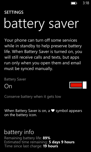

You are right. I read this at about 10am this morning and had about 95% battery left, now it is 3 hours later and I've only dropped 2% compared to the 5% I normally would have lost in that time. Hope they fix it because I like Nokia music's offline music.
I've also notices the music and video app destroying my battery while watching a movie. At the gym I entered airplane mode, had screen at high brightness, drained 25% of the battery in about 25 minutes. 1% a minute while in airplane mode and watching a movie doesn't even let you get through a whole movie while on a flight...big time disappointment.
I uninstalled Nokia Music and was surprised that the phone actually lasted throughout the day, 60% left after 12 hours (10 standby and 2 of very heavy usage while on the train).
Charging the phone overnight to see how much it drains till the morning.
I am still at 93% an hour later, and now my battery says 10 days left, which although is prob inaccurate, is more than the 1 day it had been showing around this time of day all week. Haven't changed usage at all and have only uninstalled nokia music.
