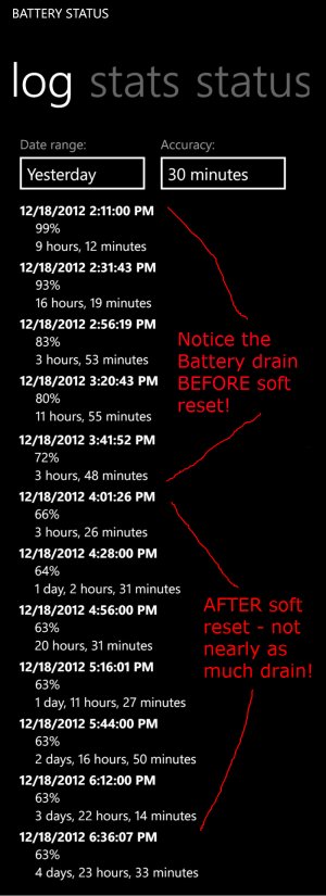

Whenever I have a feeling battery drain is going on, I do a soft reset. It seems to do something to help the battery. I've done it maybe 3 or 4 times and its worked flawlessly every time to fix the battery drain.
EDIT - Here's my battery stats from yesterday - you can see exactly where I did a soft reset. My phone was draining for NO REASON before that - nothing was going on - it was sitting on a counter not being touched. I went to check my email and noticed it was draining, so I did a soft reset, and you can see the results right after that. To soft reset, hold both the power + volume down button for 10 or so seconds. Works every time.
