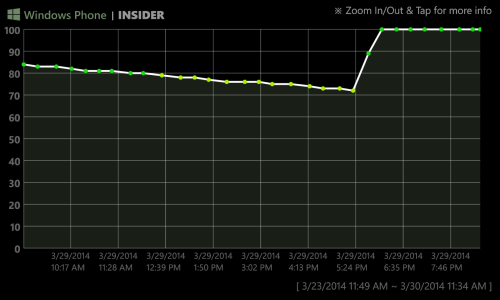

This is what I'm getting per day with low use (texting and camera mostly.)
I have just about everything turned on.

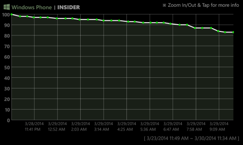

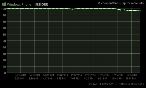

If I play Machinarium, Asphalt or watch an HD vid then 100% drops to 60% real fast of course.​
I haven't used my 925 on anything but Black since I only got it last month and updated it right out of the box. My battery life on it isn't as great as what I got out of my 920, but I can't complain. Last night, it was at 50% when I went to bed. Not bad at all. My 920 might have been 70% by that same amount of time.

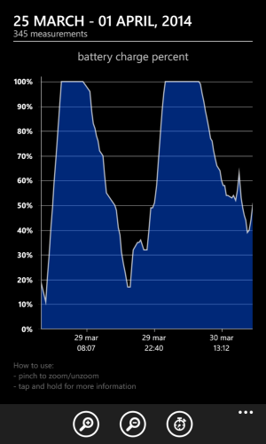

I have some major issues with batterie life to. I can barely get thrue half a day. I charge it before i go home from work !
all sync set to manuel, glance set to peek trying off now. Dobbelt tap off.

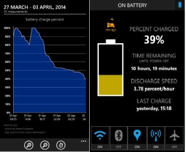

Hi. Please, after a couple of days, comeback to share how is your battery life doing. My battery life is getting worse. Today it lasted 4 hours only, the phone died after some light WhatsApp messaging and reading some news at WPC using the app (data on). I wouldn't like to do a hard reset, but I might... :(
