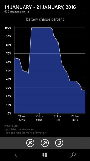

Today is not a very good day for me, because I did an insider update (from .29 to .63) and played with the camera and a game.
I unplugged from the charger at 8:56 am and now (11:04pm) am at 27% with 7 hours 51 minutes remaining.
Now my stats are
18.8% System
78.7% Display
1.5% Wifi
1% Cellular data
91.4% In use, 8.6% Background
As for the tracking app I use Battery from Enless Soft. It's an old app but it works well and doesn't consume too much (<1% in 24h).
