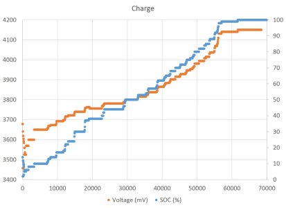

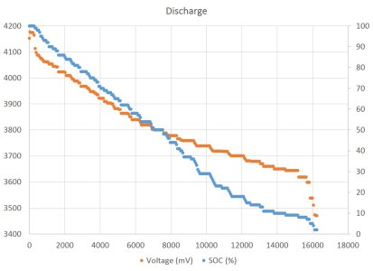

This weekend I played around with an old Android handset of mine (ZTE Blade running 2.3.4).
I put an app together that logs the battery voltage and reported state of charge (SOC) every minute into a TXT file that I can process afterwards.
For you to get a sense of how bad battery SOC tracking algorithm can be, have a look at the graphs below. The app is using the screen to execute a controlled constant power charge and discharge. Phone is only running this app and is in airplane mode. Therefore, the SOC evolution should be a fairly straight line, which it is not...
My long term goal is to build a similar app for WP but I can't read the voltage with the public methods in WP8. I opened a thread on XDA to find a way around it.
