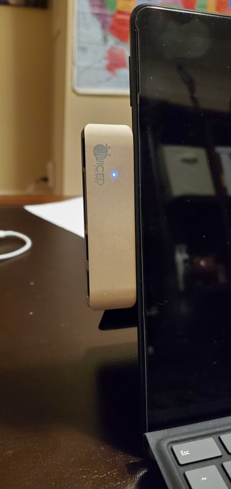

I recently tried a Satechi USB C dock that I used with my work MacBook. I'm experiencing issues using it on the Pro X.
My 2 issues are:
1. Given the placement of the USB C ports the dock cannot stay on my desk and plug in, it has to hang due to the chord's short length.
2. The USB connector wobbles a bit and loses connection. I had this issue with the dock and my MacBook pro but I wouldn't use the laptop when it was docked so it would stay still.
I'm hoping to use the dock to connect 2 monitors and then use the Surface in writing mode. Any dock would need a long enough cable to stay on my desk and still reach the ports on the X when it's in a variety of configurations with the stand.

I bought this for my wife's MacBook but works on the ProX
