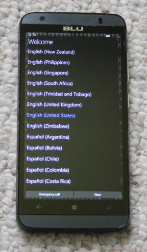

I reset my BLU Win HD LTE and put it on craigslist. I started getting what I assume is the battery issue a couple weeks ago, and last weekend the GPS stopped working at a time when I needed it. I'm back to my T-Mobile Lumia 635 running Windows 8.1 Cyan and am much happier. Here's a list of my complaints with the BLU:
* Poor GPS performance, and occasionally GPS would stop working altogether.
* Extremely poor camera - pictures are poor, video non-stop re-focuses making it worthless.
* Screen was starting to mark up around the edges. Has this happened to anyone else?
* Battery issue
* No SensorCore
* Micro-USB hookup seemed flaky. Worked fine in my chargers at home, but two different chargers in my car wouldn't work with it.
* Windows 10 groove music - poor app compared to the old XBox music for my needs. "Random" play would play a very narrow playlist - I would hear the same song sometimes two days in a row, and I have 20+G of music on my phone - there's something definitely wrong with the randomizer.
* Windows 10 navigation - not as nice as the Here app.
* Poor performance compared to the Lumia 635
>* Lumia screen, while smaller and not as high resolution, looks MUCH better than the BLU screen. Gorrilla Glass 3 versus whatever BLU used plus a screen cover.
>* Speaker for notifications, speaker phone, etc. as well as the speaker for hand-held calls is better on the Lumia.
>* Bluetooth implementation in my car is much more effective - on the Lumia it may be because of.....
>* Microphone for the video part is much better sounding on the Lumia.
>* Specific to me being on T-Mobile - The Lumia, being a T-Mobile branded phone instead of an unlocked phone, has Wi-Fi calling, which is a great feature.
>* Substantially better camera on the Lumia! Though it is only 5 MP without a flash, pictures are very good quality, and video is as well.
Just overall the Lumia 635, even though it's an older budget phone, has a more substantial, higher quality tactile experience compared to the BLU.
I will miss the large screen and Windows 10 mobile features. I will also miss the dual-SIM setup, so I'll have to carry my work phone around sometimes in off hours. (But running dual-SIM in the BLU had all kinds of little annoyances that I won't miss - most likely not related to the BLU specifically.).
