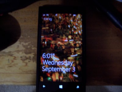

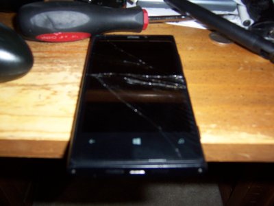

Dropped my 920 flat on the screen a few months ago from about 2 ft high, never broken a phone before. How do I know if just the digitizer is cracked or the entire display too? Are those the only two parts comprising of the whole screen or is there more?
I'm fairly technologically and mechanically competent so taking the phone apart and repairing it doesn't bother me. Just need to know what all is broken/needs replacing. I don't have small enough torx screws at this time to take it apart, else I would take it apart to see what all is broken.

If the image of the display looks discolored or has black lines or spots around the area where the glass broke, the display is damaged as well. If the image looks normal underneath the glass, you should only need to replace the digitizer.

As far as I can tell the colors look fine, there's just a lot of cracks. Touch and everything still works fine. So just the digitizer needs replacing?

I think its the other way round. If its the digitizer that broke then there would be no display at all. Since its just cracks it sounds like its just the glass

Now I'm confused... Is there three parts? Display/LCD, Digitizer, and Glass Cover? Or is it just display and digitizer? I know from the video tutorials and parts that can be purchased that the display can be separated from the digitizer.
All I know for sure is the phone still works, there's just a lot of really deep cracks in it. The colors all seem fine/normal.

If the colors are fine then the digitizer (also known as an lcd) is fine...by the look of the pic I would say its the glass....esp if you can feel the cracks

Well the thing is most suppliers offer both digitizer and LCD screen together. Btw judging from your phone it's only the digitizer that's broken. Your theory is correct. The LCD is completely fine just the digitizer requires changing.
