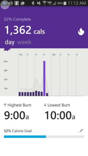

Can you let us know which OS you are using? On Android I see the workout included in the total calorie burn. See the example of today:
The total calorie burn includes the bump from the workout. Having said that, I still believe (as I have stated on other threads) that the active calorie calculation is high and the "normal" calorie calculation is low.

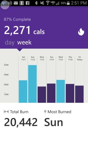

Here is my week:
Weekend - active (tennis - 5k on Sunday)
Monday Rest Day
Tuesday - Weights only
Wednesday - Cardio
Thursday - Weights only
Today - Cardio (only 3pm here)
Thoughts?
Did you use have Exercise Tracking on all the days you worked out (cardio or weights)? I think only the daily burns that show in light blue include tracked workouts. I had got my band Tuesday, and had 2 resting days in a row so didn't get into the gym until yesterday and today. Tuesday and Wednesday burns show in purple, and yesterday and today (with workout activity of 505 and 895) show light blue burn bars. Those bars are much higher than past 2 days. For the record, I'm using an Android device to sync my band.
