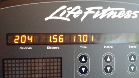

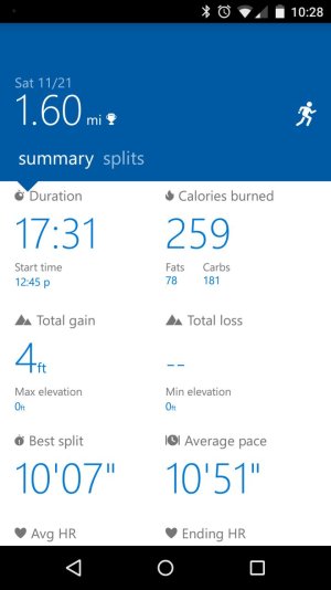

I decided to test the step tracker while running on a treadmill, and I'm pretty surprised at the accuracy. And the calorie count is different because the treadmill did not know my weight and HR. Here are the results:
