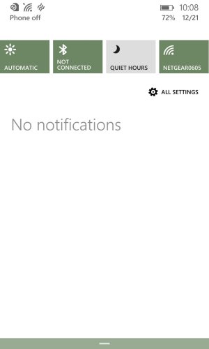

My issue with the update is the power button will not lock the phone after restart. Then once the phone screen turns off i can not turn the phone back on. I even have double tap enabled and that won't work. The picture attached shows the top left corner with "phone off" displayed. I have no idea why that is.. I have reset my phone multiple times and sometimes that will work. Most of the time it does not though. I'm hard resetting at this point. Very disappointed.
