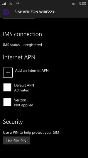

Go to Settings, Network & wireless, Cellular & SIM, and then tap on "SIM 1." It should bring up a "Properties" button. Tap that and scroll all the way to the bottom.

The problem is, on the Icon there is no option to update or configure the MMS APN Settings, does anybody know a work around? This is on build 10149:
