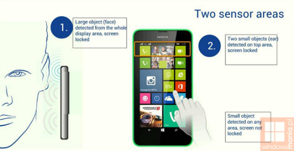

Hello,
Lumia 630/635 , does not come with proximity sensor, the device comes with a technology in touch panels that can measure electrostatic voltage. As you can see from the image , any large about placed near the upper part of display will lock the screen and there by preventing any accidental click during calls.

There isn't a fix :/ That's what kramium is trying to explain. You can try a Bluetooth headset as a workaround, but that's about it. The other option is buying a phone with the actual sensors. The 920 for example
Otherwise stick to the route I posted earlier
kramium tells you how the sensor works on the phone. The problem is, the phone thinks there are objects on the display in those areas. This is caused 99% of the time by a display that needs cleaning or has a wet spot from sweat or some other moisture source. Thoroughly clean your display and the issue should go away, until it needs cleaning again.
I recommend daily wiping with a dust-free micro fiber cloth to keep it from building up the stuff that causes the issue in the first place. Sometimes what the screen is detecting can't even be seen, so try cleaning it.
As an owner of 2 of these phones, I can tell you cleaning can fix the issue.
