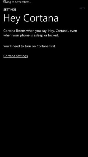

Can't enable "Hey Cortana" on W10M build 14364

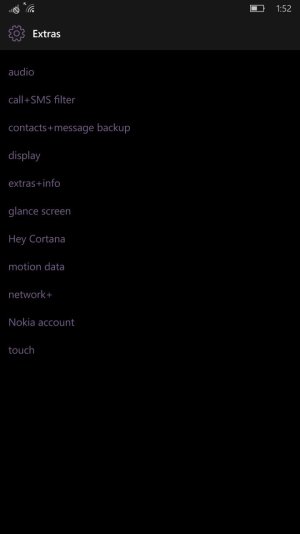

I can't enable "Hey Cortana" on my Lumia 1520. Seems the feature is broken. It will not work on W10M build 14364 or the previous one. Worked fine before going to Insider Builds. And if you're wondering about rolling back to 8.1; Windows Device Recovery Tool says there is no package available. Wrote another thread about that. BTW pressing "Cortana Settings" does nothing. No response. Here are some screenshots.

Same problem on my 1520 with latest fast ring build as well. At least my Settings link works though. Tried unchecking, rebooting, rechecking them all but no change. Also tried the older fix of installing another language but that didn't work.
