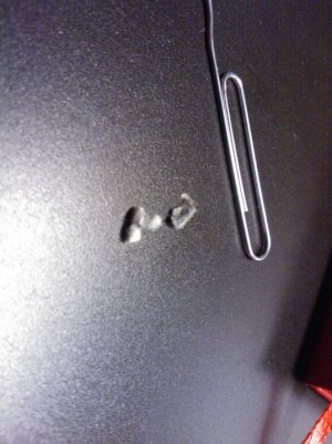

I didn't see this thread until I tried looking into the jack and reading all types of nonsense regarding software updates. I finally removed two dense balls of lint from the audio jack, after using a paper clip for half an hour. Mine was likely pretty difficult because I kept jamming my audio pin in there thinking something was warped inside the audio jack, or the earphone pin was deformed.

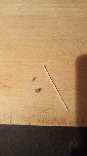

Thank goodness for this post. I had the same problem and had been jamming my ear bud plug in hard. And I had a Note 5 so I couldn't remove the battery, so I took the suggestion of using a toothpick to avoid shorting something in the jack with a metal paperclip. I got the lint out in less than a minute by twirling the toothpick which because of its square shape easily grabbed onto the compacted lint.20160406_234720_resized.jpg

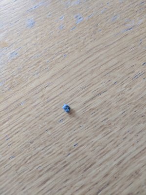

I didn't actually think this could be the reason but it actually was, the smallest ball of material
(as attached) from one of my pockets stuck at the bottom, took a bit of careful digging and dragging to get it out. Now it's perfect again!
