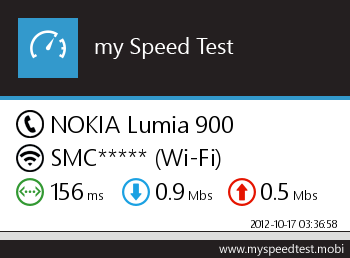

How slow is the WiFi network? I've had issues where I was unable to install apps or send MMS when I've been at coffee shops. Some of those WiFi networks were slower than EDGE speeds. This was too slow for sending MMS/installing apps.
That could have been the case! I thought it was odd that emails weren't loading very fast and Facebook was kicking out tons of errors.
