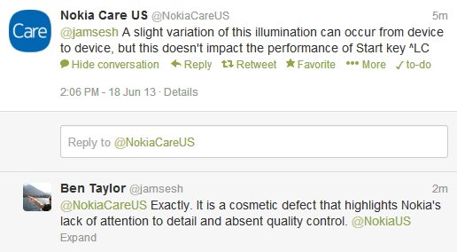

I tweeted @nokiacareus. They are incredibly responsive by the way, I highly recommend reaching out with questions or problems.
Their response, however, indicates that this is not considered a defect and there are no plans to change anything:
I'll let you know if they respond with anything more promising.
