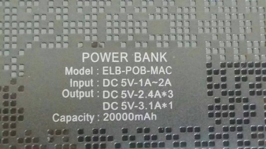

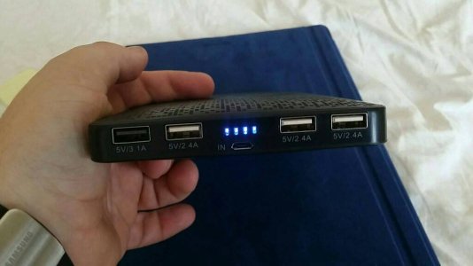

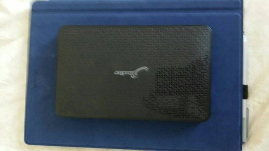

I have succesfully charged my S3 with this one.
Vinny
