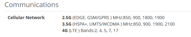

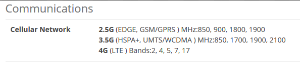

So ... after reading this it would seem that the RM-1039 Lumia 735 would be a little better overall in T-Mobile cell coverage than the RM-985? Just curious. I have both and where I live I get outstanding Tmo LTE signal.
RM-1039 Lumia 735 cell bands:
RM-985 Lumia 830 cell bands:
