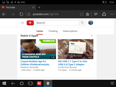

the monitor I tried support 1080P, and will show 1080P if connect thru HDMI or Displayport, but only show a resolution (I assume 1024x768 screensnap shown below)if connected thru VGA. I wish MS would add the option to choose output resolution on continuum like you can on PC/Tablet.
and if you wonder which adaptor I was using, it is the Vtin one shown on the Screen Shot of youtube here.
PS: it turns out the screenshot is only 640x480, which is a shame, since the monitor is 1080P, I would love to try other monitors, but all my display at home are DVI/HDMI only , so I have to try when I get a chance for projectors or so.
