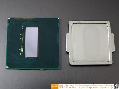

Erm okay, the IHS or "CPU cover" (on the right hand side) is the element that interacts with the heatsink in any cooling mechanism in a laptop or PC. The CPU itself does not interact directly with third party heatsinks.
You will need to relid the CPU and ask the seller if he is providing the IHS with the CPU.
I suggest you watch this videos from Gamers Nexus to get you started :) :
https://youtu.be/w9i_ULemBhI
https://youtu.be/jbTi5Ed89Yk

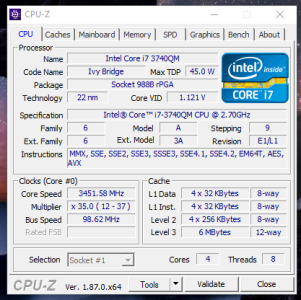

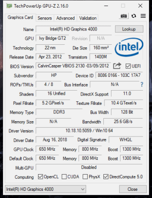

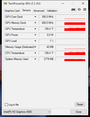

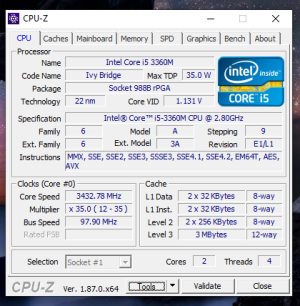

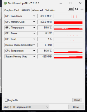

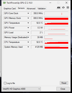

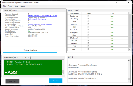

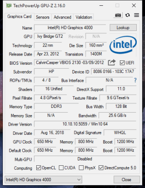

I look at the videos and didn't find that on my cpu even with the one that was in the cpu socket. No cpu cap of any kind ;s anyway here some pics from old cpu to new cpu.
Old CPU
Old GPU
Old CPU temps idle
New CPU
inew cpu dle temps
new cpu stress test
When I took off the heatsink. I didn't see no plate on top of the cpu like you were showing me on these videos. Though if you look at my recent posts. Things looks good. :)
