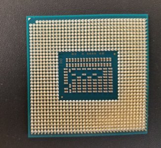

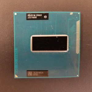

CPU Scratched.... Would it still work?
When I took off the heatsink. I didn't see no plate on top of the cpu like you were showing me on these videos. Though if you look at my recent posts. Things looks good. :)
Interesting, guess to reduce height the OEM removed the IHS.

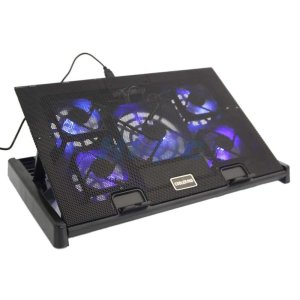

Id say very weird. Though on that note right now my cpu at idle is at 55C I presume there no way to get it down to 45C like the duel core was?
Nope, not without any modifications or an external cooling solution like a laptop fan(s) attached to the base. Such as this -

The CPU looks fine, not sure how you're going to place the heatsink though, the top part where you apply the thermal paste seems to be missing. The bottom looks fine. You can order and try the CPU since you have 5 days warranty. If the CPU is DOA you can always claim on eBay if not you can always open a dispute with Paypal.
