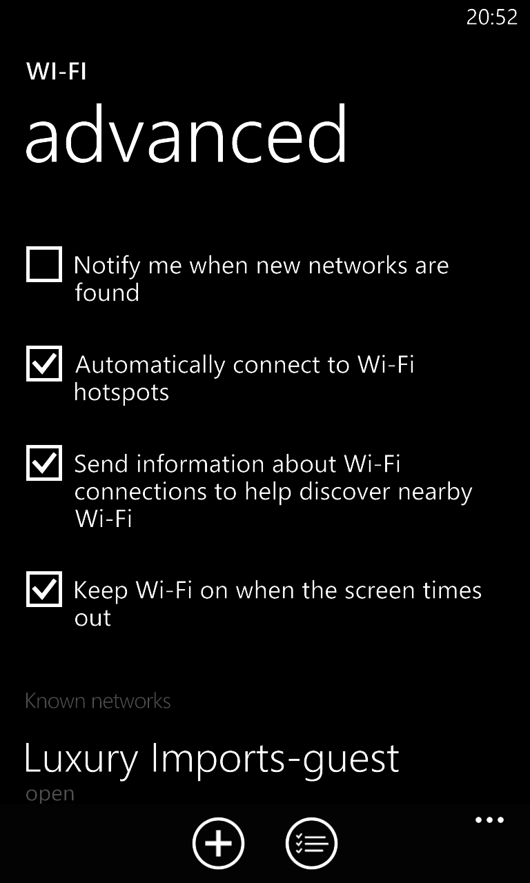

Do you have notify when new networks are found enabled or disabled? Maybe it's looking for other networks instead of staying locked into your preferred network.

I only have "Keep Wi-Fi on when the screen times out" enabled. The other 3 options are disabled.

Have you tried my settings? My WiFi connects when I'm outside my apartment in my car and never drops inside my apartment.
